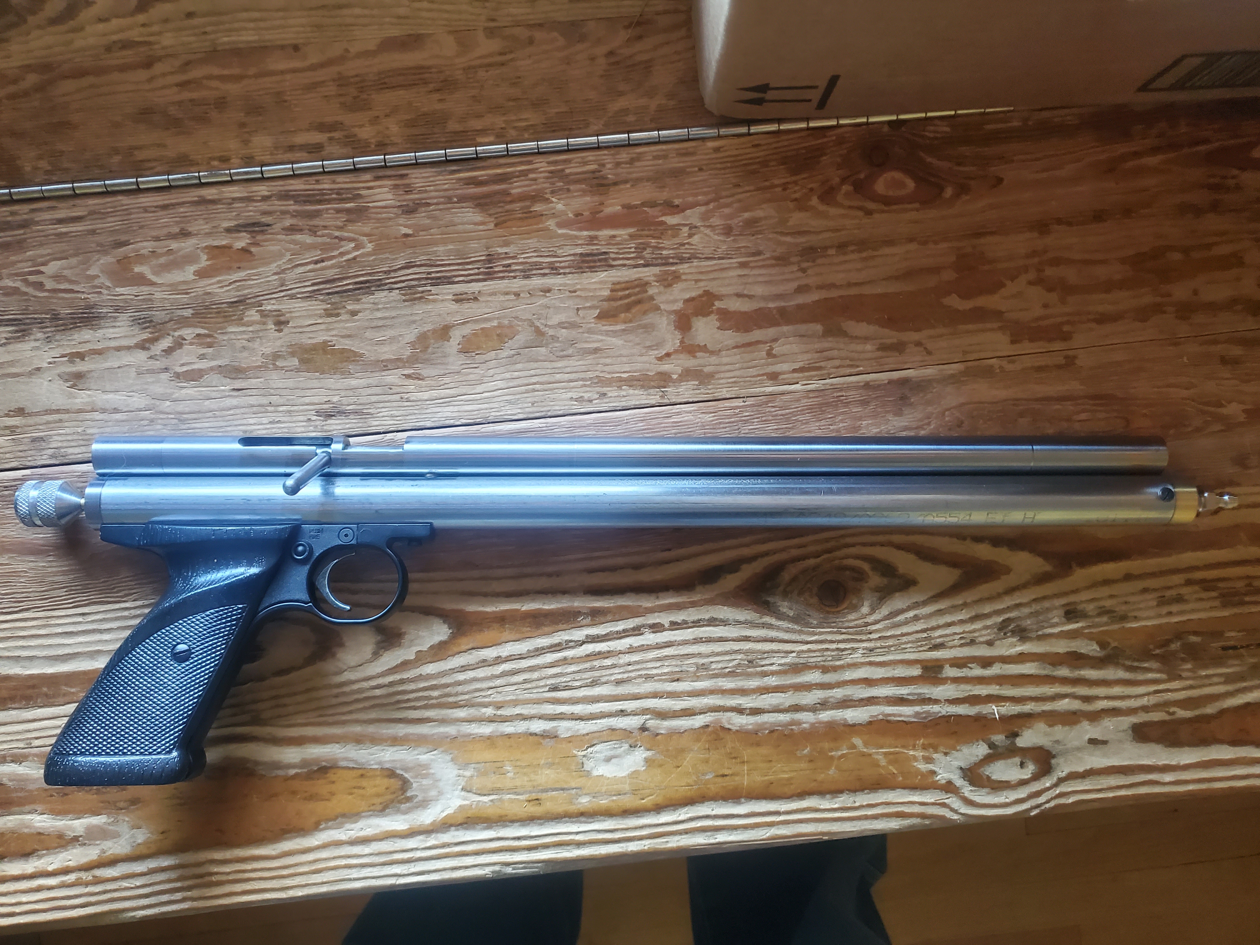

Done some more to it today. Got the rear piece done that ties the back of the breech to the pressure tube and made a cocking knob.
I am also honing in on the reliability issues and everytime I solidify one thing, the problems become less. Im awaiting some specific orings and I think it'll be complete AND have plenty of power still. It's dumping all of the tube so I'm going to try to add a block in the middle of the pressure tube with a small orifice to limit the volume of the shots. I'd be happy with 2.

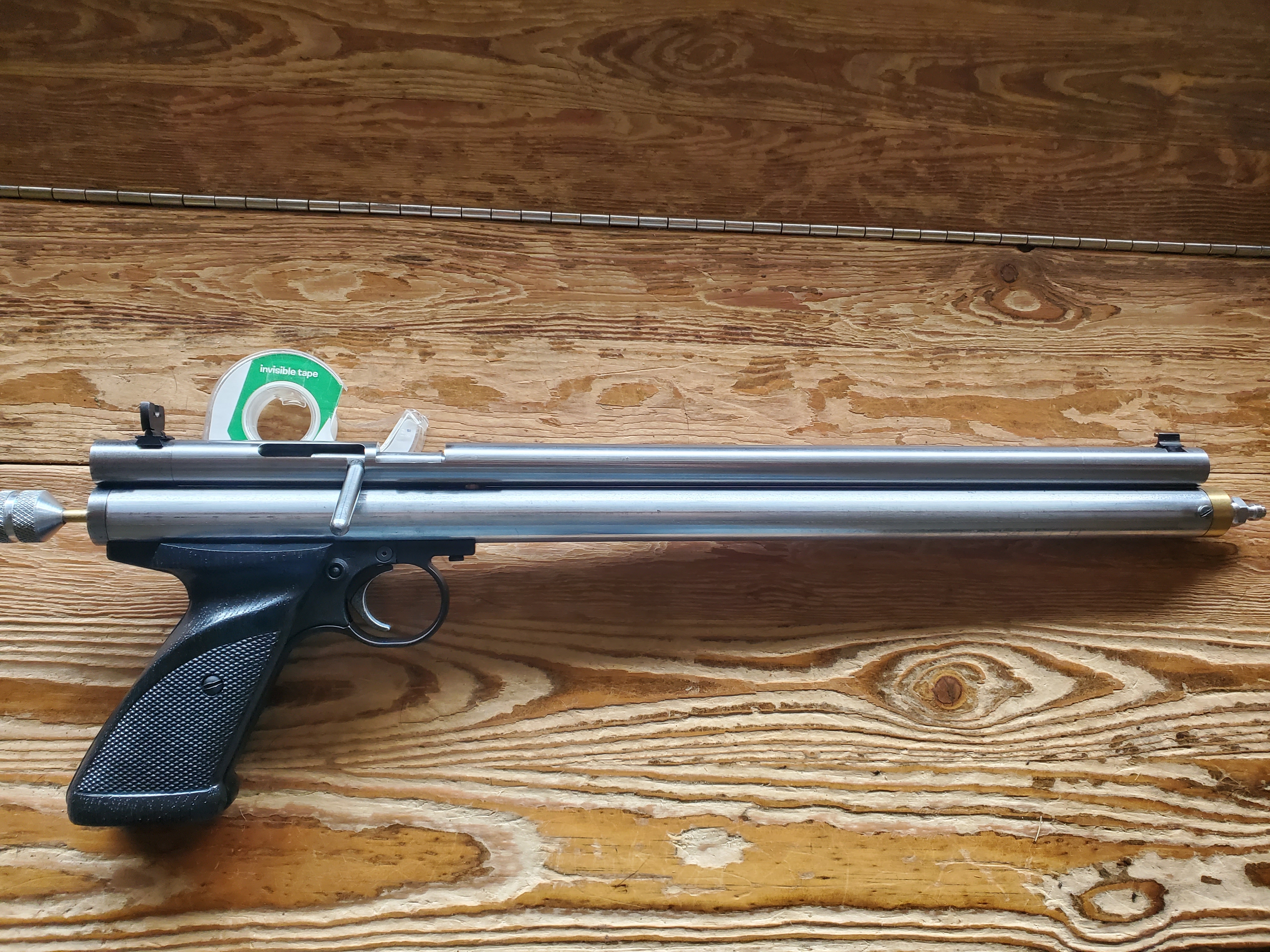

I got tired of messing with my new valve design so made a more compact version of the valve that I invented for my 50 caliber, still top secret 😎.
The pistol is now reliable and can be shot without issue. Also cut dovetails and installed sights. I bought some 83 grain .358 pellets that won't register on my chronograph that maxes out at 1100fps! It's an airgun chrono. This thing is ridiculous. This valve isn't as powerful as the experimental one but it's close and it's reliable. I thought I was testing 148 grain bullets but they are 158 grainers that I was getting almost 800fps at.

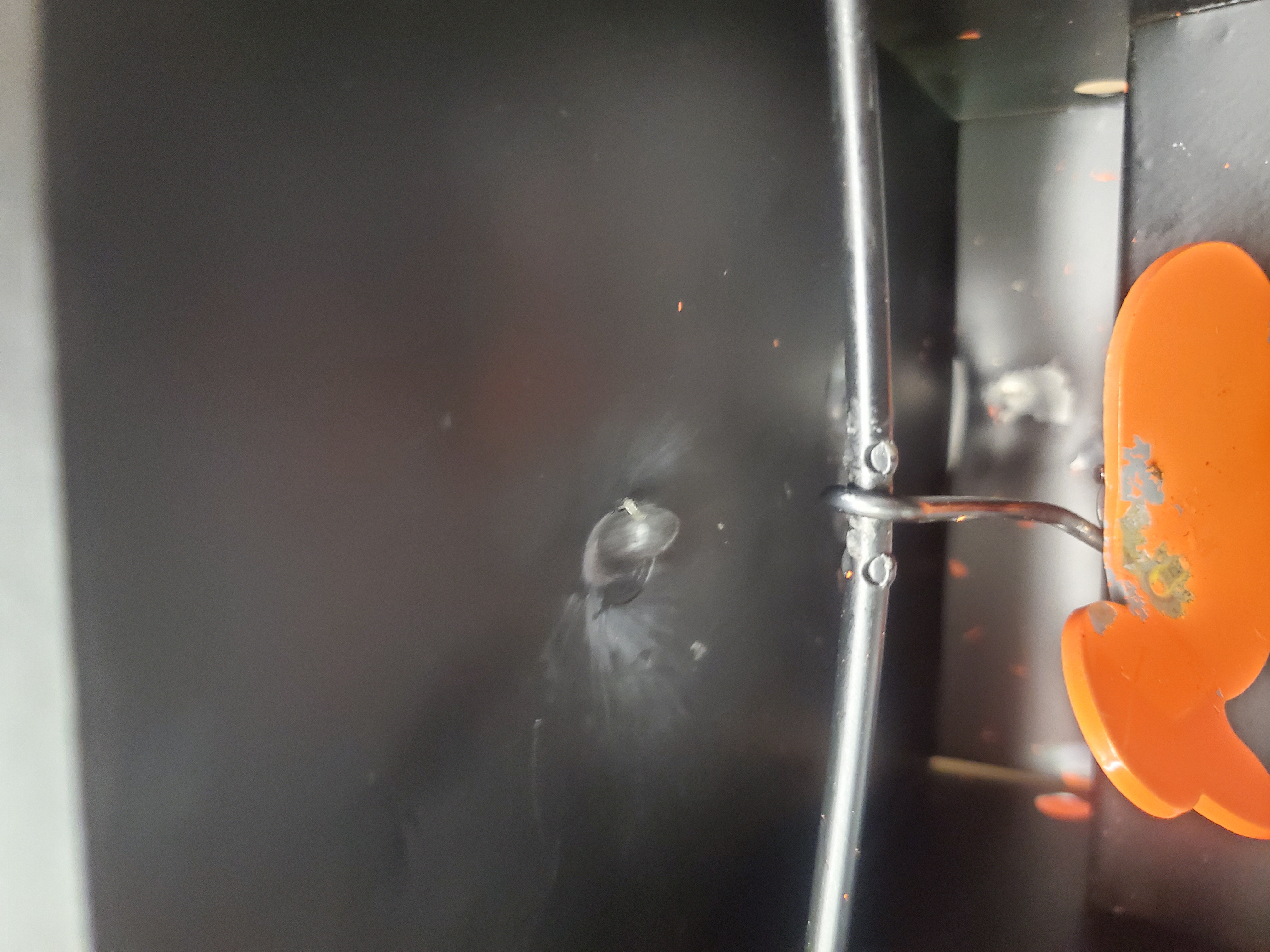

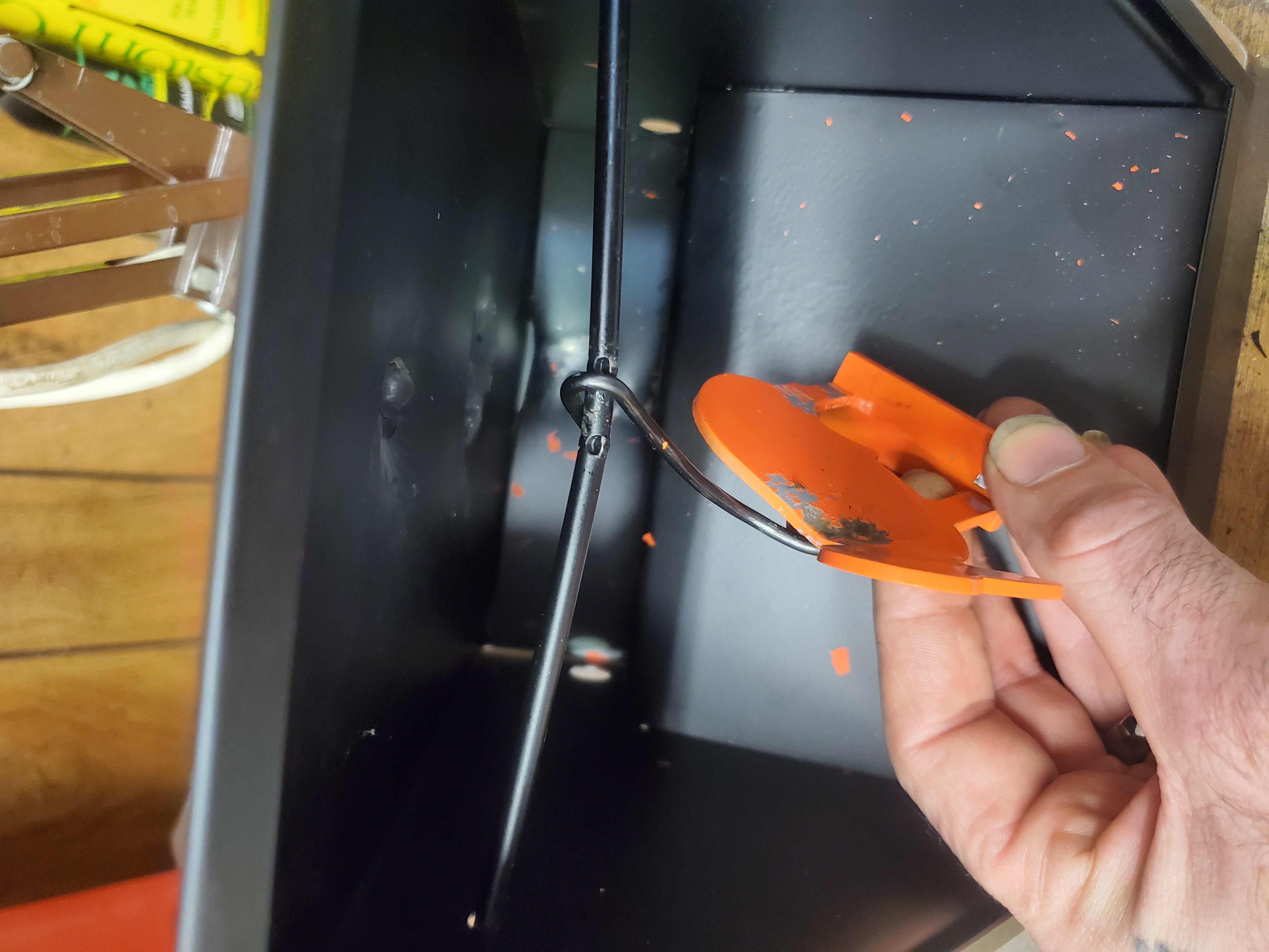

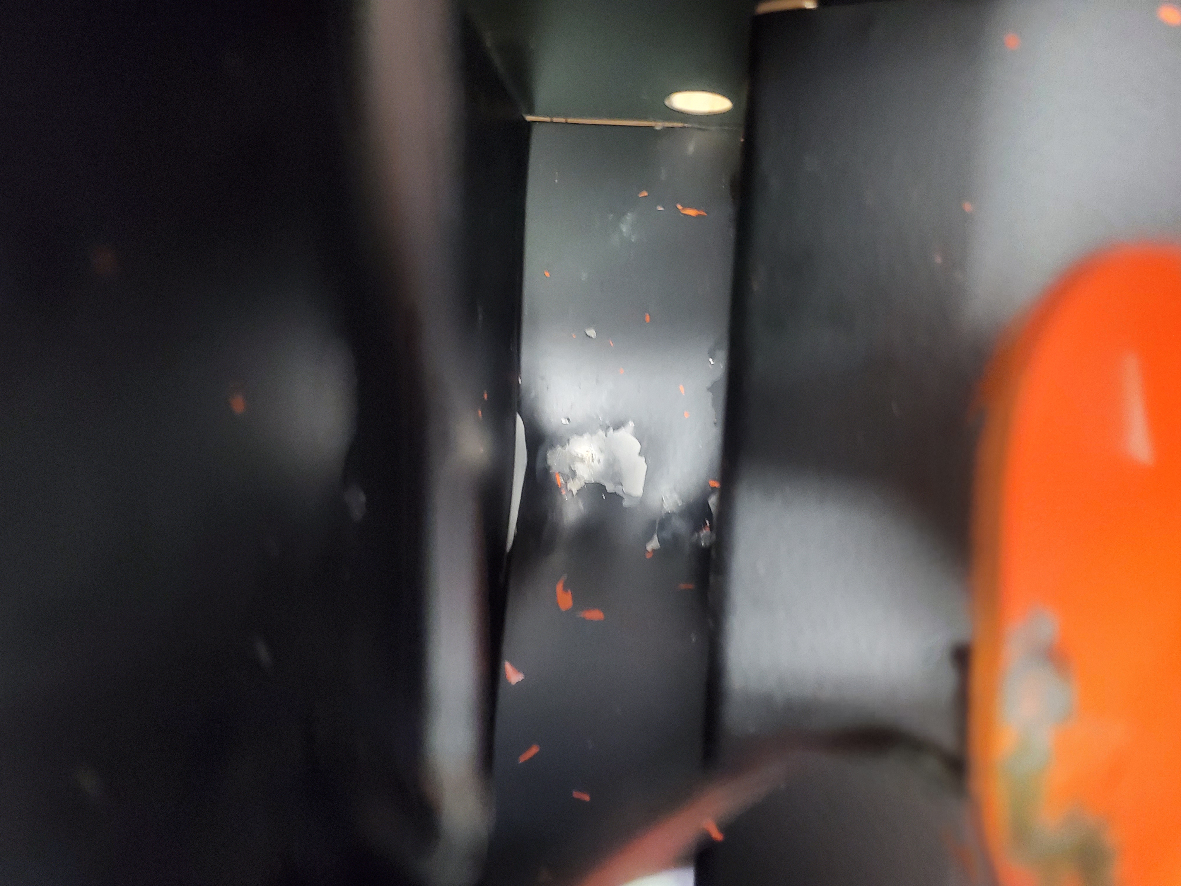

As promised. The swinger is 1/8 thick steel. The housing is doubled over 1/16 steel. The back of the trap is tapered so the bullet struck it, dented the hell out of it then went down and dented the bottom of it too. Second shot on Mr Ram who didn't fair too well. These were the 82 grain pellets.

Dang!
That is NOT the Crossman that I grew up with.

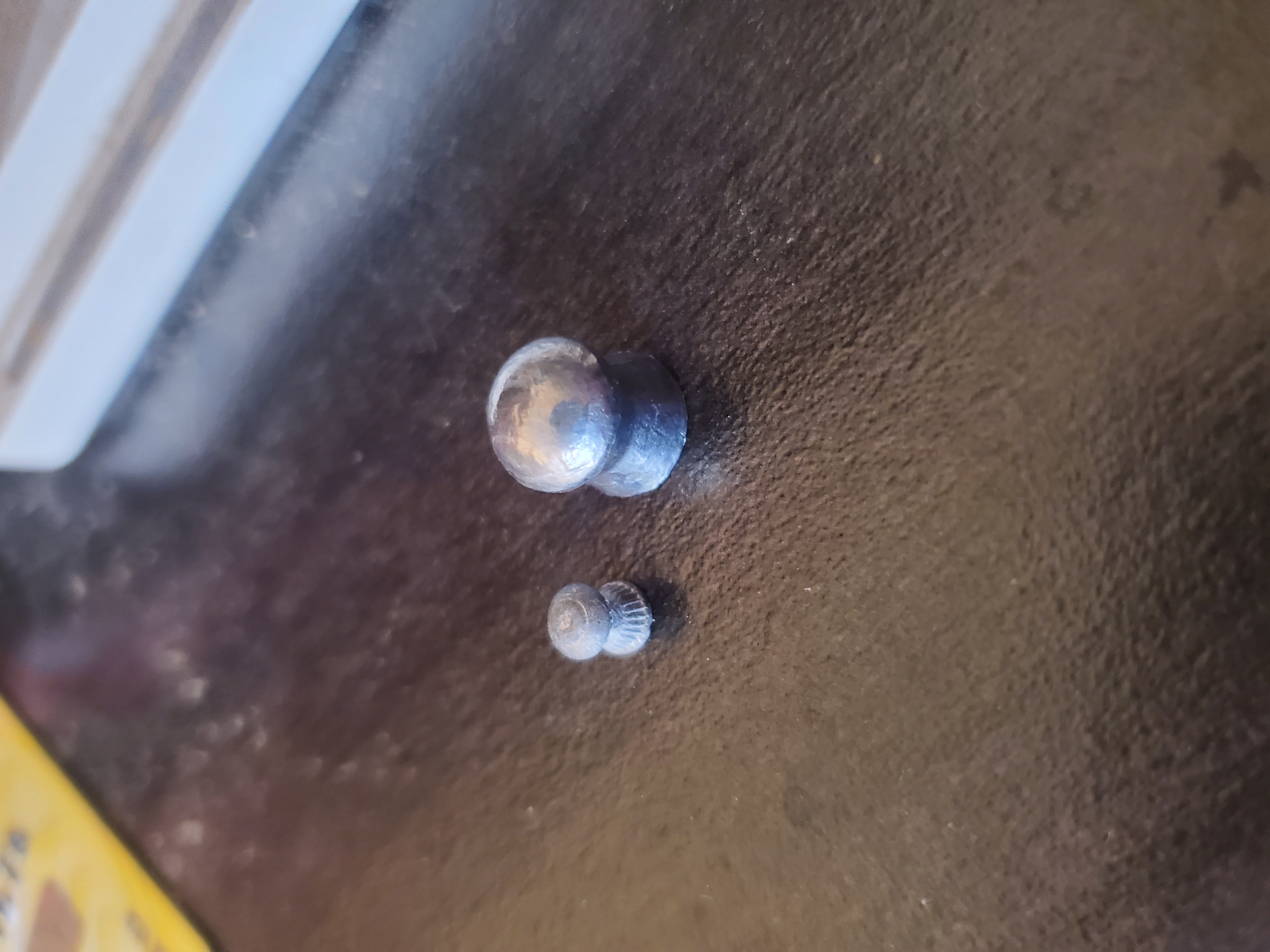

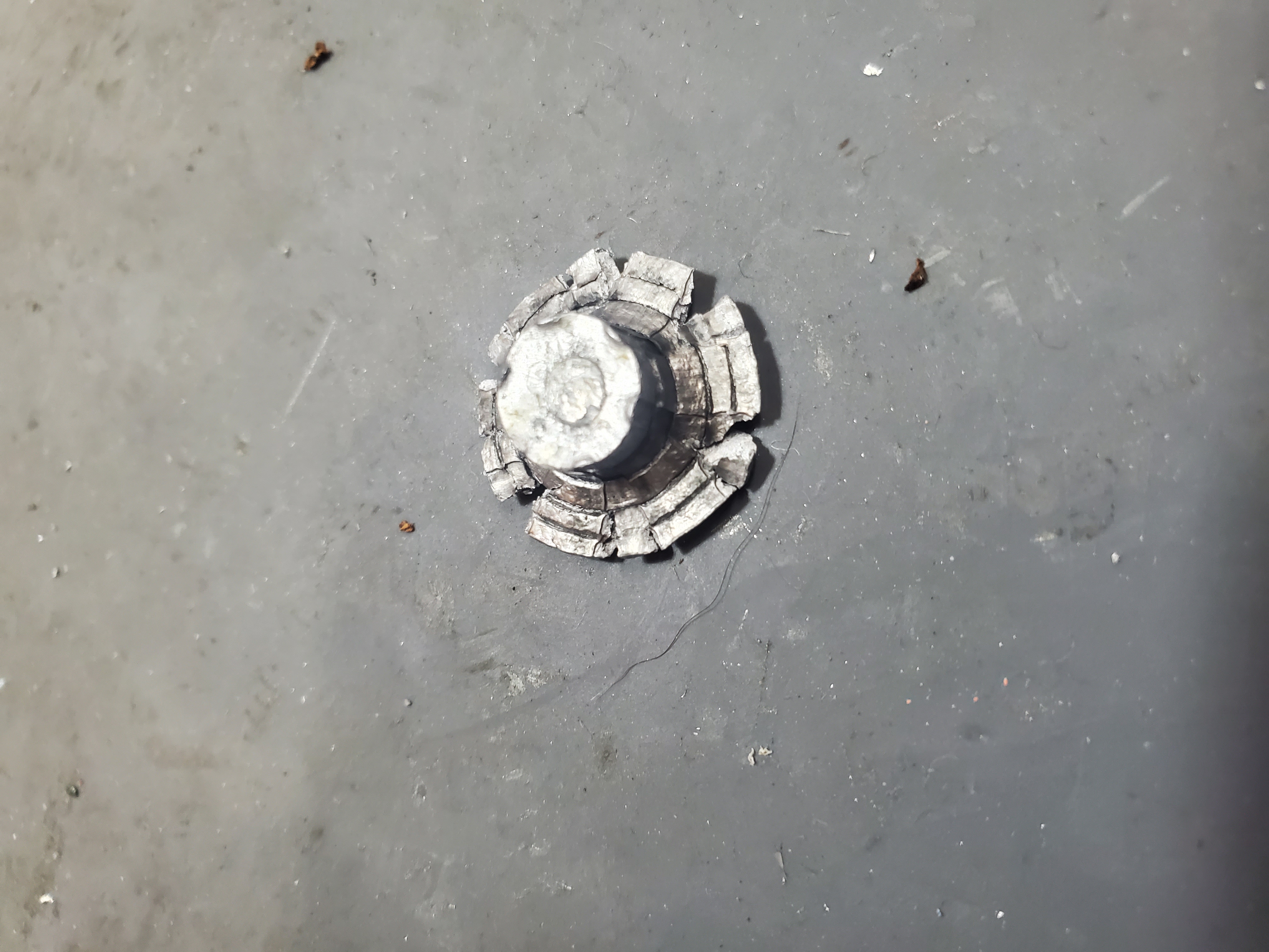

Just for kicks I sent one at a 3/4" thick piece of aluminum. It put a small impression in it but the wad cutter looks impressive.
Posts: 603
Re: 38 special or 357?
Was that some hard aluminum?
To "expand " a wadcutter like that must have put a real smack on it.
