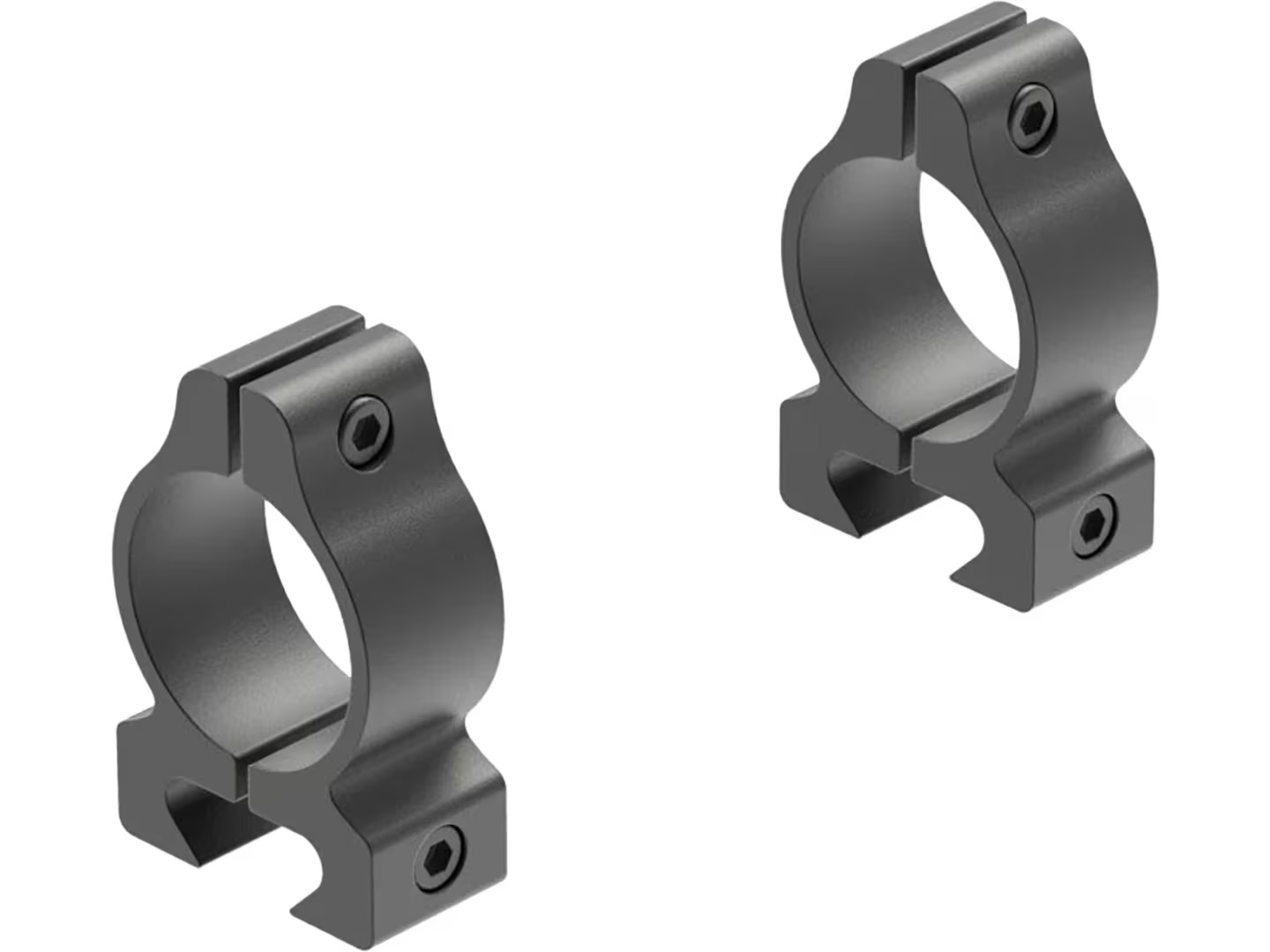

I've forgotten all I knew about putting a scope on a rimfire. What are the grooves on a rimfire? Weaver size or something like that?
Posts: 850
Re: Rimfire scope mounts
As long as you buy "rimfire" rings you should be good. I think the size is 3/8" or 11mm.
Posts: 4107
The grove is 3/8th. Get Leupold rimfire scope mounts. Unlike many others they are split in the center so they center themselves over the grove. I HATE the standard ones with a claw on one side. They almost never center accurately and over the years I’ve replaced all of them with the Leupold. They’re only $20.

Posts: 2770
I use those Leupold mounts a lot on centerfire rifles and revolvers. Inexpensive and work well. Never had an issue with them for cheap.
Posts: 4107
Zee wrote: Thu Mar 06, 2025 8:04 pm I use those Leupold mounts a lot on centerfire rifles and revolvers. Inexpensive and work well. Never had an issue with them for cheap.
Yep, you got me started with the center fire ones and then I found the Rimfire version and bought 10 of them on my first order. They rock!
